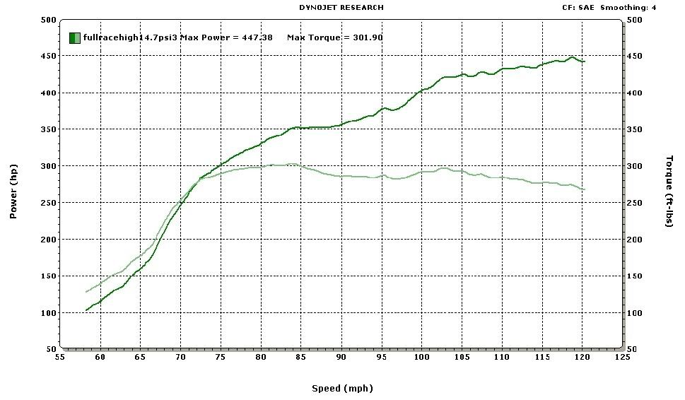

Heller litt bensin på bålet jeg.....
http://www.cheesefrog.com/frog/tehbeast.wmv
800whp dyno..(hvorfor gidder jeg egentlig?? :rolleyes:)
og en liten teaser, 1,8l gsr HONDA.
1 BAR trykk (14,7psi)
Sitat fra jeff evans(tuner)
I have tuned 8 600whp+ stock sleeve engines. It can be done, and has been done already. All of the engines except one are still running.
The one went at the track, when a stock valve cracked and took out the entire cylinder (9k+ shifting). That is something that i have no control over.
Our shop car engine has seen well over 150 dyno pulls at 600whp level doing testing for full-race, and recently hit 690whp at 37psi when the boost controller was set too high.
The engine has seen over 50 passes last season trapping 135-145mph each time. All of the other stock sleeve engines are in the 135-145mph trap speed range as well. It comes down to good parts, correct engine tolerances (especially piston to wall clearances!!) and super conservative tuning.
Obviously there are no guarantees, and shit breaks. That is racing and high performance engines in general. I have had enough good success with high power stock sleeve applications that i am comfortable recommending builds using them to customers, as well as building engines with stock sleeves for customers. At the same time i do recommend sleeving to customers that are looking for 100% reliablity for a race engine.
I have pushed bone stock engines to the 400whp-500whp range (on race gas). Stock internals, stock sleeves. These engines have lasted for a full season as well. If ppl dont believe that stock sleeves are strong enough, what about stock rods and cast pistons?

Det er interessant det her, har alltid sett for meg at nyere Hondamotorer tåler mye, men interessant at de tåler både den varmeutviklingen som 600-700 hester gir (kanskje 40% går med til varmetap), pluss at de samtidig er holdbare med det turtallsområdet de opererer på.
Men når det gjelder 2 bars ladetrykk... Om motoren har 180 HK uten overlading (la oss si at dette er 180 HK ved nøyaktig 1 bars atmosfærisk trykk), da regner litt grovt (uten hensyn til tenning, med 100% virkningsgrad på IC) på 1 bars overtrykk så får man da 180 * 2 = 360 HK. Ved 2 bars overtrykk er det da: 180 * 3 = 540 HK. Derimot endrer man den opprinnelige VE, slik at motoren suger i seg til 200 hk uten overlading, vil regnestykket bli annerledes: 200 * 3 = 600 HK. Det som gjør effektøkning utover dette er racefuel som tillater høyere tenning, mens det som virker negativt inn er IC-virkningsgrad.

ja Sånn er det i teorien, men om en liten turbo med 3cm i diameter pusher en bar, og en stor på 10cm i diameter pusher 1 bar er det forskjellig luft mengde som kommer inn.
derfor fungerer denne teorien heller dårlig her. meen fortsatt en god måte å regne ut ca effekt ja.
disse motorene blir tunet med ganske konservativ fortenning. ligger vel rundt 21*-22* fra 7000 og opp
varmeutviklingen er nok enorm og kan kjøres i korte perioder.
Men alikevel finner jeg det ganske facinerene at det går, og det holder mye mer enn forventet.
Nettopp, nettopp. Kombinasjonen av enorm turbo, originalt aggressive kammer, effektivt utformet grenrør og innsugsmanifoild, mye turtall samt svært gode originale portkanaler er ting som kaster "common sense" og konvensjonell motorteori på havet. Hondamotorer flest er laget for å yte bra i N/A-tilstand (les: høy volumétrisk effektivitet på høyt turtall), og kombinerer man dette med et par kilo ladetrykk fra en svær turbolader blir summa summarum mye toppeffekt. Kort giring, slik at man holder seg på toppen av powerbandet, slicks og Quaife ATB-diff er også ting som hjelper bra på kvartmil-tida; i tillegg til andre faktorer som man har nevnt tidligere (først og fremst latterlig lav egenvekt).

Hvorfor er det forskjellig luftmengde som kommer inn da? Jeg er nok ikke helt enig i det. Men om du forklarer litt så kan vi kanskje komme til enighet etter hvert :)
Spennende å se hva disse orker! Men Øyvind, du skriver her "common sense" og konvensjonell motorteori på havet", her er det vel heller snakk om at konvensjonell motorteori har blitt brukt hos fabrikken (her Honda), slik at resultatet ble bra.. Selve motorteorien i seg selv blir jo fortsatt stemmende :) Common sense er også en typisk feilkilde, hvor man går rundt og tror og innbiller seg.. Common sense trengs derfor ikke med motorer, her kan alt regnes ut og prosesseres på en riktig måte, noe som Honda helt tydelig har skjønt for lenge siden!
Akkurat det med turtall og VE er litt spennende her, siden man har godt over 5757 RPM å ta av, og momentkurve som ligger høyt her vil gi større utslag i HK.. Men det som her er å trimme på uten overlading er jo VE, holde det på samme turtall men øke flowen enda mer, så en forandring her i form av noe moment vil jo gi store effekter i form av hk.. VE derimot kan man på en måte lese mer i form av moment (om man har i bakholdet motorvolumet).. Hmm, dette ble litt OT i grunn.. Unødvendig å forklare dette.. Men nå er det sagt :)
