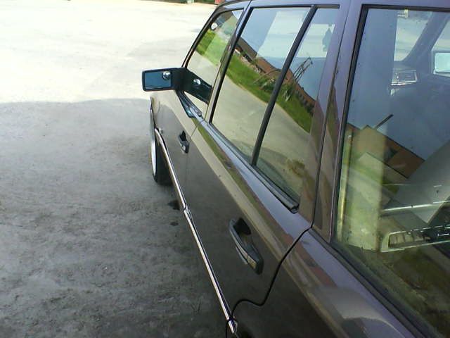

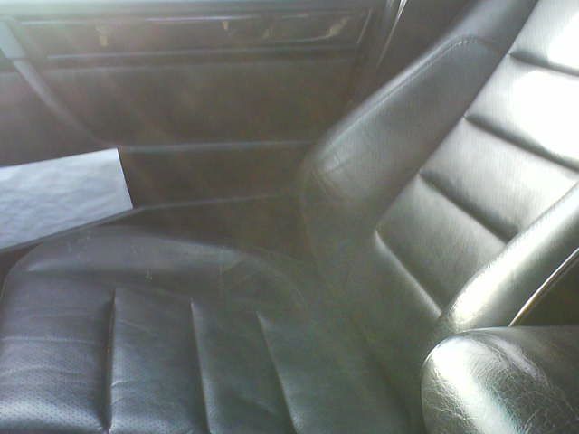

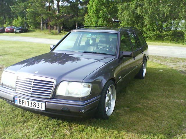

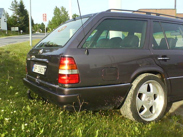

Einar Skrevet Juni 9, 2009 Rapporter Share Skrevet Juni 9, 2009 Da blei det til at jeg kjøpte meg S124 jeg og da, en `91 TDT, med skinn, sportline og litt utstyr uten at det er noen utstyrsbombe. Bilen hadde kun sportline-understell og ratt/kule fra fabrikk, noen har vært så vennlige å utstyrt den med komplett sportline-skinn, 2 delt baksete i tillegg til dette. Noen utstyrsbombe er det dog ikke. Er en del å gjøre med bilen, men håper det er mulig å få bil ut av igjen med litt kjærlighet. VIN WDB1241931F184501 Model 300 TD TURBODIESEL Chassis 1241931F184501 Engine 603960 12 033220 Transmission 722357 03 545868 Order 0 0 247 02789 Lights BOSCH Wiper BOSCH Delivery date 29.04.91 Dealer Reutlingen branch (247) Interior cloth black (061) Paint 481 bornite (blackberry) metallic (с 01.01.1990 по 31.12.1996) Options 211 automatic limited slip differential (ASD) (с 01.07.1984) rear axle with automatic limited slip differential (ASD) 260 elimination of model designation on rear lid (с 01.05.1968) 261 elimination of model designation V12 (с 01.11.1973) 281 trunk set, (280 SL) steering wheel with sports design (390 mm dia.) and gearshift lever in leather trim (с 01.05.1990) steering wheel (390 mm) with sports design (с 01.03.1989) 291 airbag for front passenger airbag for driver and front passenger (с 01.07.1987 по 30.09.1993) airbag for driver and front passenger (if driver airbag standard - then only for passenger) 300 storage box in front tray (с 01.05.1988) 412 electric sliding roof with tilting device (с 01.07.1983) 243 - sports seats, front and rear (from 01.12.1986) Ettermontert 537 mechanically operated antenna and front loudspeaker - without radio set (с 01.10.1989) 541 double roller blind used as luggage and passenger guard (с 01.01.1980) 553 trailer coupling and anti-theft warning system (с 01.11.1978) 586 Behr air conditioner, and electric window lifters (front and rear doors) (с 01.04.1970) 591 heat-insulating glass, all-around, heated rear window pane, (single-sheet safety glass), Germany green heat-insulating glass all round, heated rear window, single pane safety glass - Germany (с 01.01.1972) 653 sports chassis with 8-hole light alloy rims (с 01.01.1990) 724 cargo anchorage (с 01.04.1979) Problemene er oljelekk/forbruk motor, bremserør, reimstrammer, rust og EU, tror det skal være overkommelig. Litt bilder fra annonsa: http://www.detali.ru" data-cite="\"Utstyrsliste fra http://www.detali.ru" data-ipsquote-contentapp="forums" data-ipsquote-contenttype="forums" data-ipsquote-contentid="217922" data-ipsquote-contentclass="forums_Topic">vin WDB1241931F184501 whc WDB chassbm 124193 chass_ident 1F184501 type 124 subbm1 193 subbm2 auxiliary_drive body body_code delivery_date engine 603960 12 033220 front_axle1 front_axle2 heater interior 061 lights BOSCH model_idx 1 odometer order_num1 0024702789 paint1 481 paint2 paint3 paint4 paint5 platform production_num1 production_order_ref rear_axle1 rear_axle2 release_date retarder rims service_num steering trailer transfer_case transmission 722357 03 545868 vin_dc vinwhc winch wiper BOSCH 910429 Code Текст 211 AUTOMATIC LIMITED SLIP DIFFERENTIAL (ASD) 260 TYPE DESTINATION ON TRUNK LID - ELIMINATION 261 TYPE DESIGNATION ON FENDER / SIDEWARD DELETION 281 AMG PERFORMANCE STEERING WHEEL 291 AIRBAG FOR FRONT PASSENGER 300 Unknown 412 Unknown 537 MANL. ANTENNA AND SPEAKER, FRONT - WITHOUT 541 DOUBLE ROLLER BLIND USD.AS LUGG.AND PASSENG. GUARD 553 Unknown 586 Unknown 591 Unknown 653 SPORTS CHASSIS WITH 8-HOLE LIGHT ALLOY RIMS 724 CARGO ANCHORAGE 481 UNDERSHIELDS 061 Unknown Siter Bilforumet.noÆres Super Moderator `84 Ford Granada 2.3 L Turnier`92 Ford Scorpio 2.9 GL Lenke til kommentar Del på andre sider More sharing options...
merce-123 Skrevet Juni 9, 2009 Rapporter Share Skrevet Juni 9, 2009 (endret) gratulerer så meget med skikkelig grom vogn Einar!;) Den var jælare rå! Har du kjøpt den i Notodden? er Notodden-stuk på den i hvertfall... helt perfekt høgde på bilen også syns jeg. Større klarin bak enn foran, sånn det skal være. Endret Juni 9, 2009 av merce-123 Siter nuverende bilpark: *Mercedes s124 x 2, 94/95 e300D-24v/250td *Mercedes 300tdt x 3, alle tre er w123* *BMW 745ia e23 3.2 turbo - 1983* *BMW 3.0csl motornord banebil - 1969* Lenke til kommentar Del på andre sider More sharing options...

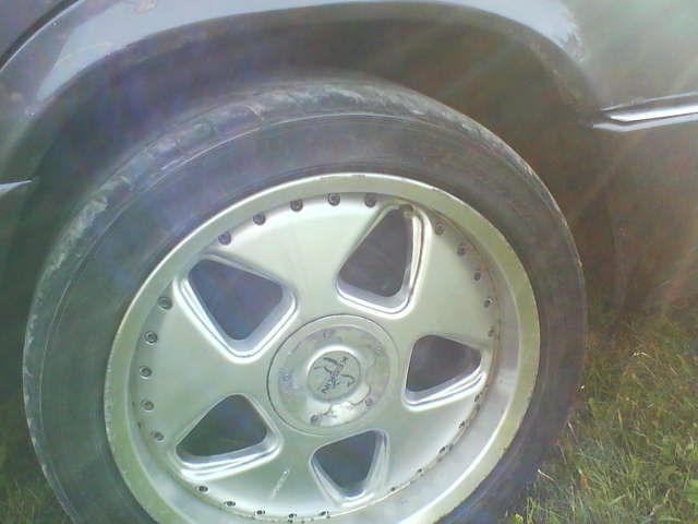

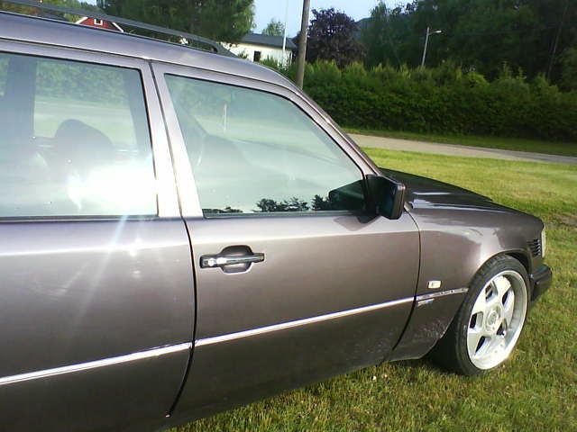

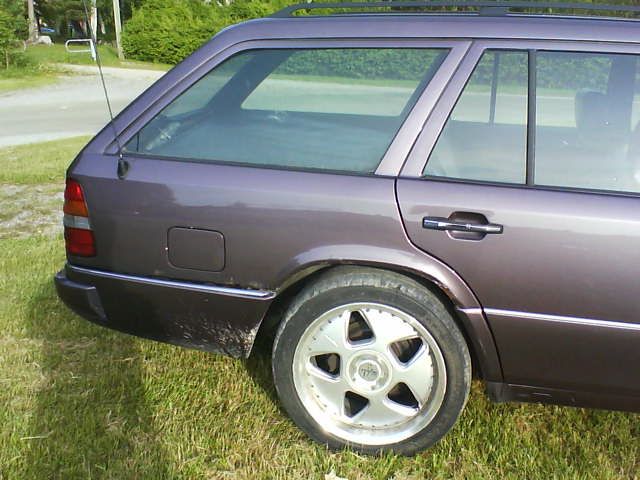

Stig73CamaroZ28 Skrevet Juni 9, 2009 Rapporter Share Skrevet Juni 9, 2009 Gratulerer med bilkjøpet ja! :) Ser jo meget pen ut på bildene, stilige felger var det også! Får håpe ikke rusta har tatt helt overhånd, ser det er litt på hjulbuen iallfall. Ellers virker denne rimelig godt utstyrt, og interiøret ser jo slettes ikke så ille ut heller;) Fin vogn, var egentlig ei sånn vogn jeg var på utkikk etter før jeg handla min også. :) Siter Lenke til kommentar Del på andre sider More sharing options...

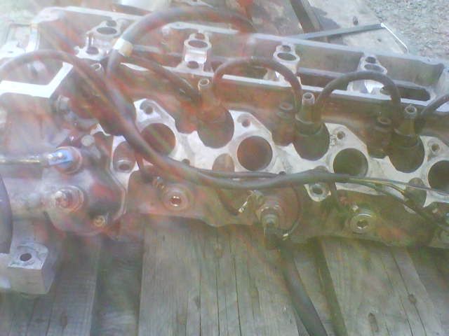

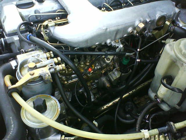

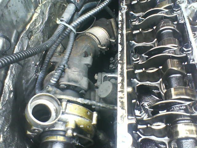

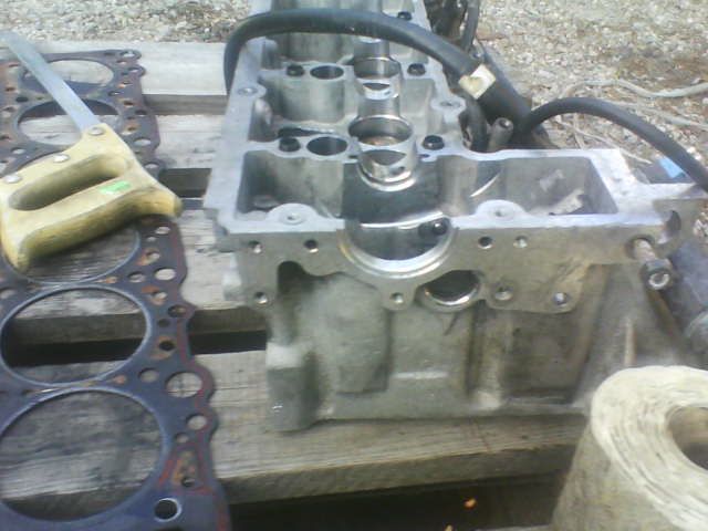

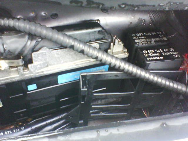

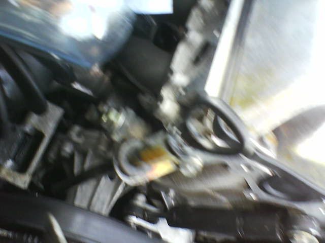

Einar Skrevet Juni 10, 2009 Forfatter Rapporter Share Skrevet Juni 10, 2009 Nå har jeg begynt å demontere toppen for skifte av topppakning. Har også tatt en del bilder. Blei noen bilder i går som dere ser. Siter Bilforumet.noÆres Super Moderator `84 Ford Granada 2.3 L Turnier`92 Ford Scorpio 2.9 GL Lenke til kommentar Del på andre sider More sharing options...

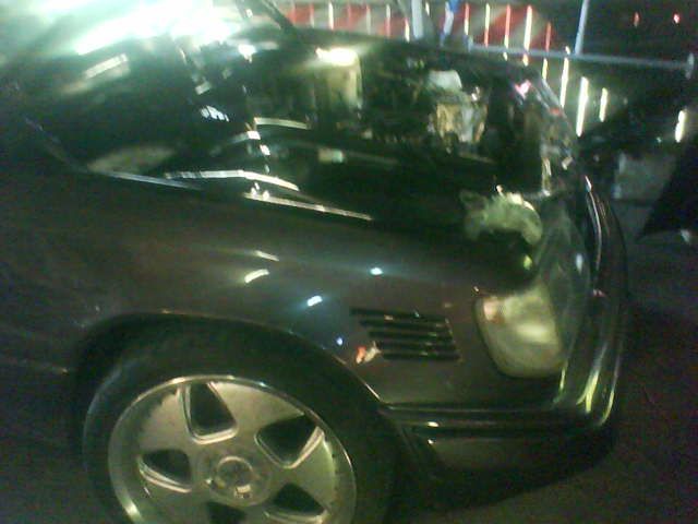

Einar Skrevet Juni 13, 2009 Forfatter Rapporter Share Skrevet Juni 13, 2009 Nå skal jeg ut å heise motor i det hjemmelasga "huskestativet" mitt. Og endelig ut med bunnpanna.... Siter Bilforumet.noÆres Super Moderator `84 Ford Granada 2.3 L Turnier`92 Ford Scorpio 2.9 GL Lenke til kommentar Del på andre sider More sharing options...

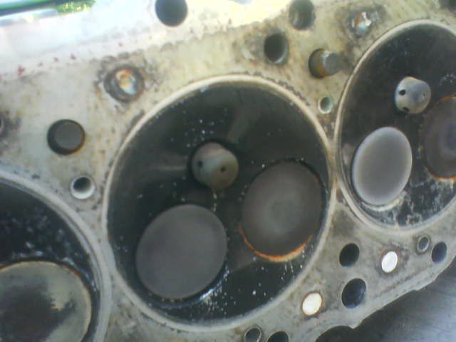

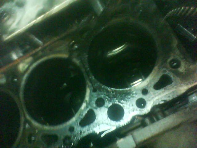

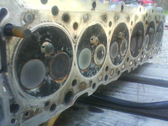

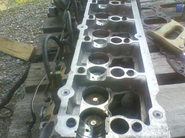

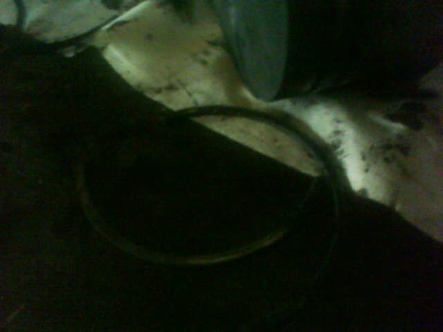

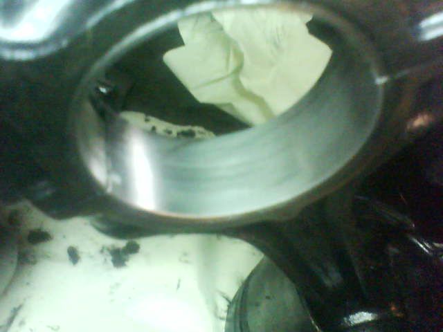

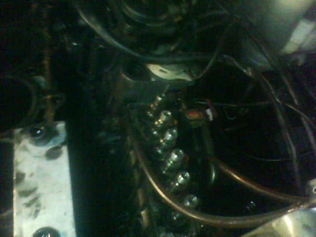

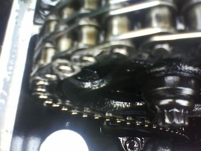

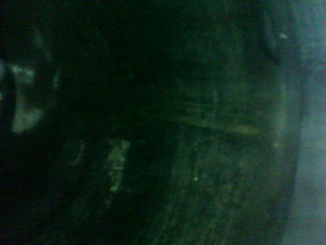

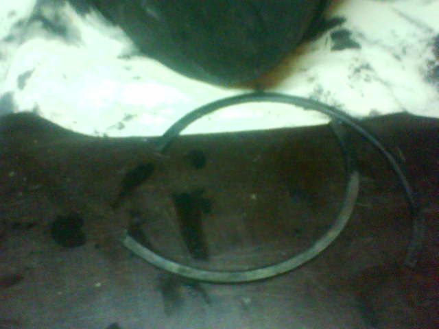

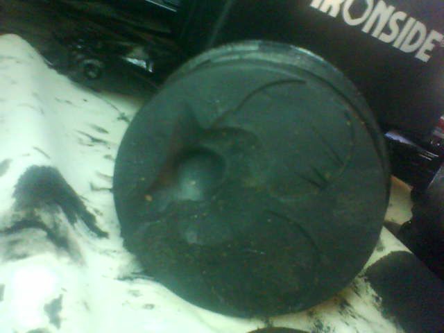

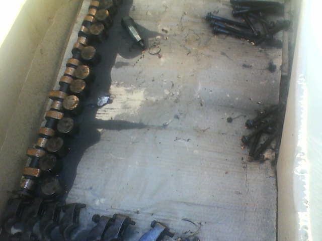

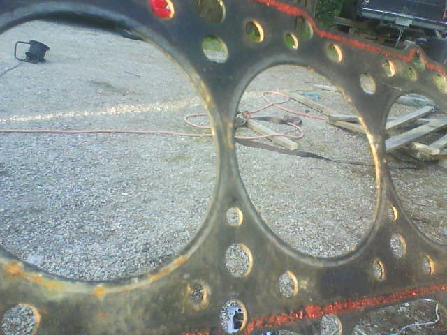

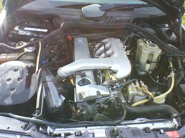

Einar Skrevet Juni 14, 2009 Forfatter Rapporter Share Skrevet Juni 14, 2009 Ser nok finere ut enn den er, er en del utvendig rust, men virker som det er relativt bra for rust ellers. Har falt helt for disse selv, kvaliteten, lettskruddheten, kjøreegenskaper, komfort og lett og billig deletilgang gjør det vanskelig å ikke like dem, og 17" felger, breie dekk og noen runder mindre gjør underverker for både utseende og veigrep. Liten update her: Liten motorsjau på gang, litt bilder: Slik ser altså toppen ut under. Blokka Toppakninga Var moden for ett skifte, men hadde ikke havarert enda. Knekt nedre kompresjonsring på Sylinder 3 og 4 Kun riper i sylinder 4, slik så det ut. Rådelager sylinder 4. Siter Bilforumet.noÆres Super Moderator `84 Ford Granada 2.3 L Turnier`92 Ford Scorpio 2.9 GL Lenke til kommentar Del på andre sider More sharing options...

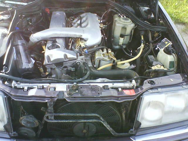

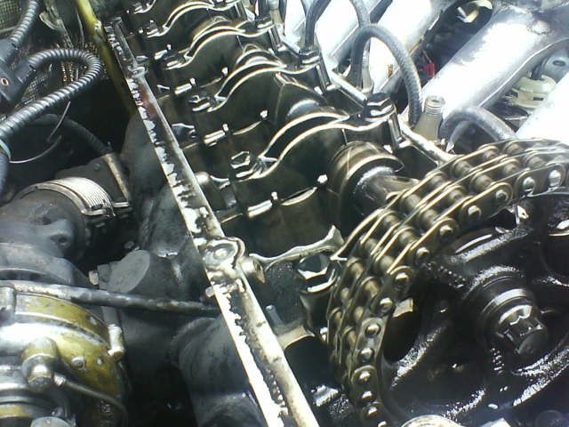

Einar Skrevet Juni 14, 2009 Forfatter Rapporter Share Skrevet Juni 14, 2009 Og her kommer alle motorbildene jeg har tatt under jobbinga hittil, beklager om noen bilder kommer omigjen... Står fint planta i naboens grasje .-) Siter Bilforumet.noÆres Super Moderator `84 Ford Granada 2.3 L Turnier`92 Ford Scorpio 2.9 GL Lenke til kommentar Del på andre sider More sharing options...
JChE Skrevet Juni 14, 2009 Rapporter Share Skrevet Juni 14, 2009 Så ut som toppakningen ble skifta i riktig tid ja :D Hvordan vil du si kvaliteten er på bensin- kontra dieselmotorene i disse? Det er vel diesel som er veien å gå kanskje? Siter Bilforumet.noSuper ModeratorNYE FIRMABILREGLER NÅ! www.facebook.com/firmabil 2017 Opel Ampera-E og 2012 Toyota Auris Hybrid Lenke til kommentar Del på andre sider More sharing options...
