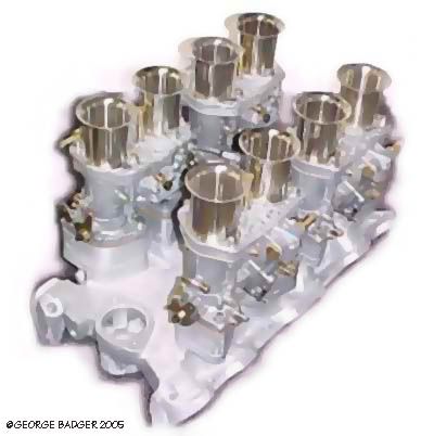

Maybe I will put 4 weber-carberators with manifalts on the v8:eek: !

the v8 engine mounts is modifyed and also the manifoilds is heavely modified!
