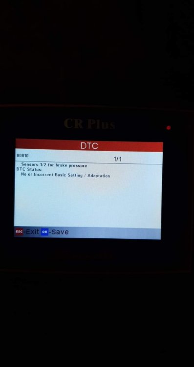

Antar det er en 06 Passat?
Få noen med VCDS til å utføre en adaption, kan løse problemet.
Brake Pressure Sensor 1 (G201)
Prerequisites:
  • System voltage at least 12.0 V.
[Select]
[03 - Brake Electronics]
[Measuring Blocks - 08]
Group 005
[Go!]
Check field 1, the value has to be between -8.0 and +8.0 bar.
[Done, Go Back]
[Security Access - 16]
Enter 40168, to enable the basic setting.
[Do it!]
[Basic Settings - 04]
Group 066
[Go!]
Activate the Basic Setting.
[ON/OFF/Next]
After a successful basic setting, field 2 should say "OK".
[Done, Go Back]
To make sure the basic setting was succesful, check the sensor again.
Group 005
[Go!]
Check field 1, the value has to be between -3.8 and +3.8 bar.
[Done, Go Back]
[Close Controller, Go Back - 06]
