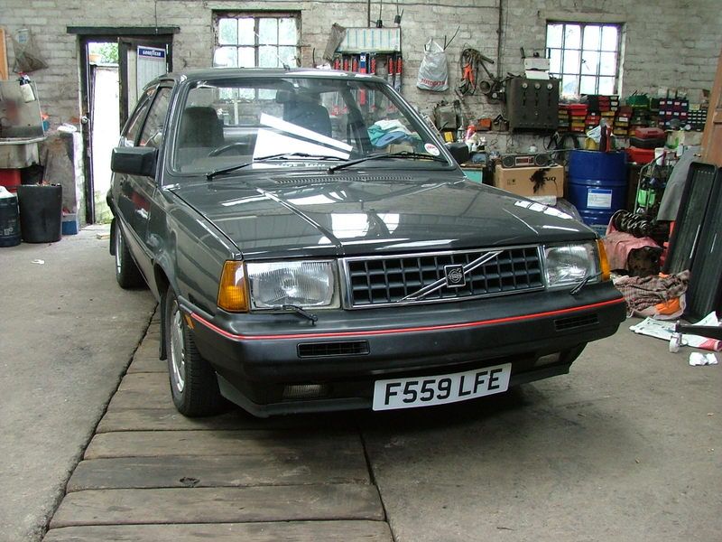

Right well a bit about myself i have grown up with Volvos from an early age, i am now 20 years old and this 340 is my first car, It started off as a stock looking 1.4 car which i bought for £127 with a collapsed front strut.
Anyways much changes later it now has a 2000cc 16V williams clio engine in the car with ported and polished head, and manifolds. and chipped ECU, car has a 2.5" downpipe and a 2" exhaust system which exits in front of the rear wheels. The car is approx 175BHP at the moment on stanadard Camshafts and will keep up with Skidracer's MK4 NA Toyota Supra.

How it started
How it looks now
