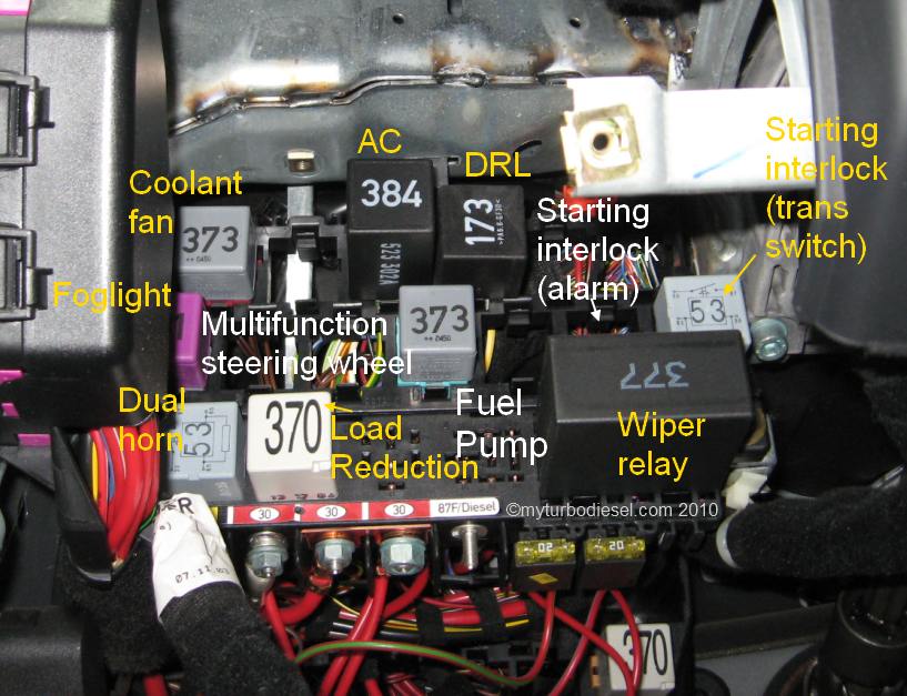

  1. 1 - Auxiliary Emergency Flasher Relay (404) 2 - Relay for Motor Remote Unlock Rear Lid (79) 3 - Starting Interlock Relay (53) (185) (465) 4 - Fog Light Relay (53) 5 - Control Module for Multi-function Steering Wheel (450) 6 - Control Module for Multi-function Steering Wheel (450) 7 - Daytime Running Lights Change-over Relay (173), from April 1999 8 - Daytime Running Lights Change-over Relay (173), through March 1999 9 - Dual Horn Auxiliary Relay (53) 10 - Glow Plug Relay (180) 10 - Warning Lamp Auxiliary Relay (200) 11 - Park/Neutral Position (PNP) Relay (175) 12 - Power Supply (Terminal 30, B+) Relay (109)
    Relay Panel:
    1 - Dual Horn Relay (53) 2 - Load Reduction Relay (18) (100) 4 - Fuel Pump (FP) Relay (409) V - Wiper/Washer Intermittent Relay (192) (377) (389) VI - Wiper/Washer Intermittent Relay (192) (377) (389)
