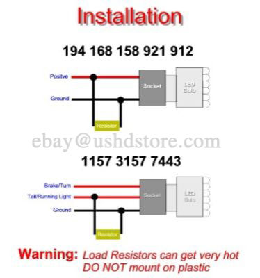

fikk nye LEDs til skiltlysa her om dagen. Da de andre begynte å blinke å sluttet å funke:( Nevnte det for selger å da sa han at:
Thanks for contacting Calmotor Inc, if burnt out that fast, it is not the LED bulbs problem, I think you might need a load resistor to control your amp draw. LED bulbs suppose to last a lifetime but if vehicle have problem then you will need to install resistor.
http://stores.ebay.com/US-Home-Direct/Resistor-Flasher.html

This is happening cuase your vehicle is not compatible with LED bulbs(low current draw) few customers do have these problems. Don't worry, you can easily solve these problem by adding load resistor, load equalizer or electronic LED flasher. (Auto Zone, Kragen,Pepboy,Radio Shack or any auto part stores might have it.
